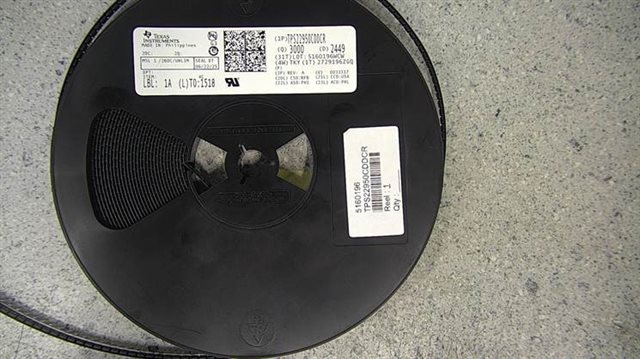

We ordered the TPS22950CDDCR part number.

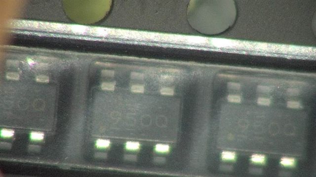

The component we received is marked 950Q, instead of 950C.
Arrow says they are equivalent.
However, the maximum current of the 950Q version is 0.5 A lower than the commercial 950C version, 2.7 A instead of 3.2 A.
Are they actually the same component?
