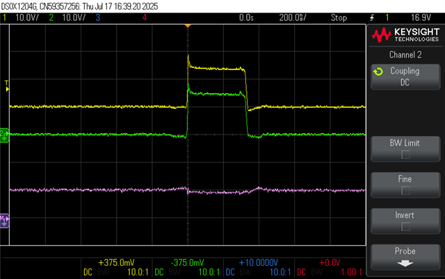

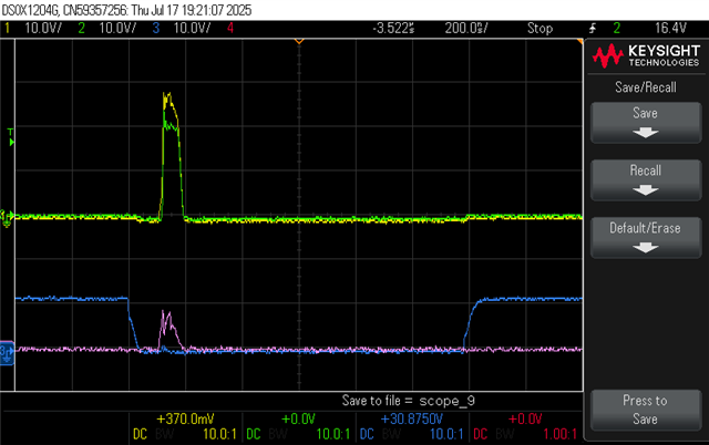

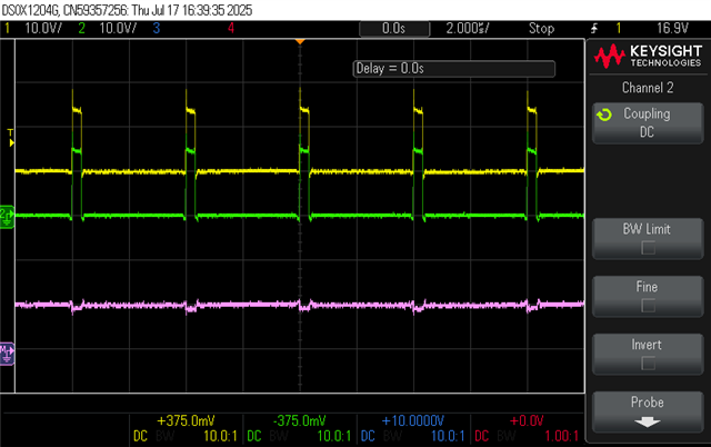

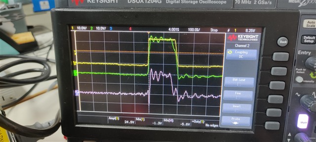

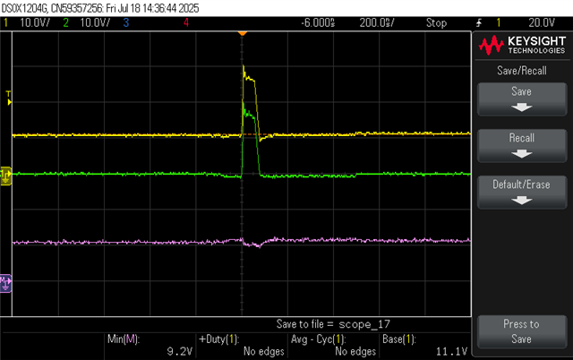

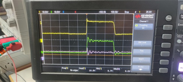

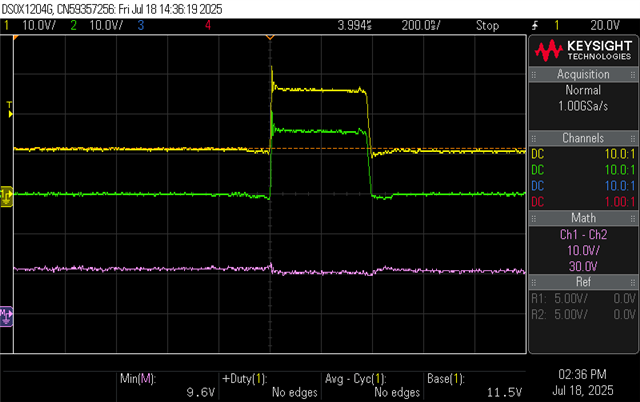

I am experiencing Glitches with my DCDC Converter which cause the Highside MOSFET to turn off earlier than the HI Signal.
Normal Pulse (200ns)
  • CH1 = HS - GND
  • CH2 = HO - GND
  • Purple = HO-HS
Abnormal Behavior (70ns)
  • CH1 = HS - GND
  • CH2 = HO - GND
  • Purple = HO-HS

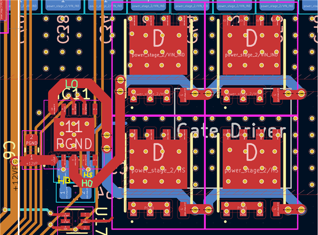

- Gate Resistance: I experimented with different Gate resistors. A gate resistor higher than 5 Ohm seems to improve the behavior. From this I conclude that abnormal behavior is somehow caused by oscillations on the HS gate. The traces of HO and LO are quite long which are causing a high inductance.
 board-power_stage_2.pdf
In the next iteration of my design i am planning to shorten HO and LO traces as much as possible. Furthermore, the Bootstrap capacitor will be placed on the upper side next to the Gate driver and decreased to 100nF.

    Looking at the first two waveforms shared, the HS waveforms appear to be okay but there is definitely some noise seen in the HO and HO-HS waveforms. What probe are you using to measure HO-HS? All of these measurements need to be taken at the pins of the gate driver with high bandwidth probes and utilizing the tip and barrel method of measurement when possible.
    1. Please take these waveforms again considering the recommendations above and also including the HI waveform.
    2. The minimum pulse width spec for this part is 40ns, so any input pulses shorter than that can expect to see shorter or no outputs.
    3. Please reference the schematic review template that is linked on the product page when doing your next board iteration. In short, I would advise RC filters on the inputs, having gate resistors populated for HO and LO, having the HO, LO and HS traces be short and sufficiently wide, placing the VDD and bootstrap capacitors as close to the drivers as possible and sizing them based on this application note: Bootstrap Circuitry Selection for Half-Bridge Configurations. If you would like us to do a full schematic and layout review for that iteration, you can make an e2e thread for that and we can advise.
    4. Looking at the 200ns waveform, HO falls some before the HS falling edge and therefore HO-HS goes low also. For the 70ns waveforms, the oscillations on HO go low and so HO-HS does as well. When taking these, it may be helpful to put HO and HS on the same scale and line them up vertically to see how HO vs HS in comparison to the HO-HS waveform.

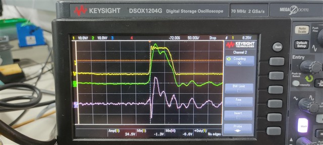

    I am using the Keysight N2140A passive Probes set to 10x
    - I was able to capture better waveforms which include HI and lined them up according to your description

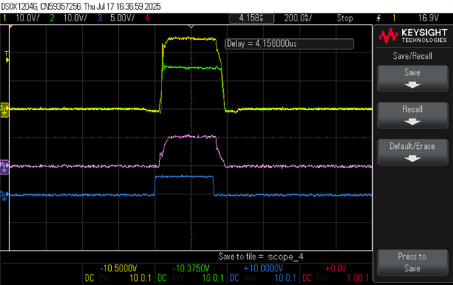

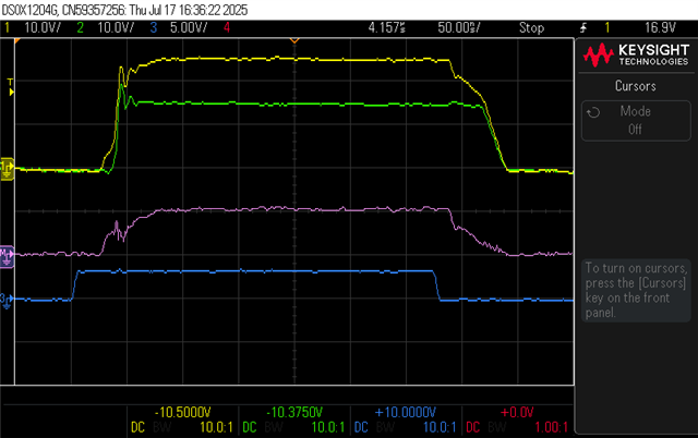

    Normal Pulse
    • CH1 (Yellow) = HO - GND
    • CH2 (Green) = HS - GND
    • CH3 (Blue)    = HI - GND
    • Math (Purple) = HO - HS

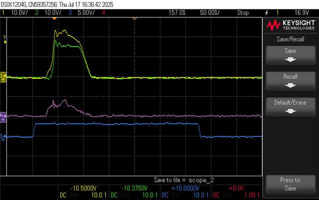

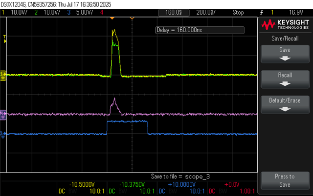

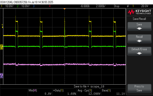

    Abnormal Behaviour

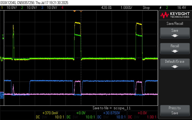

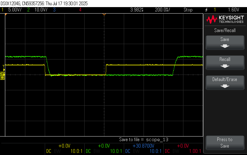

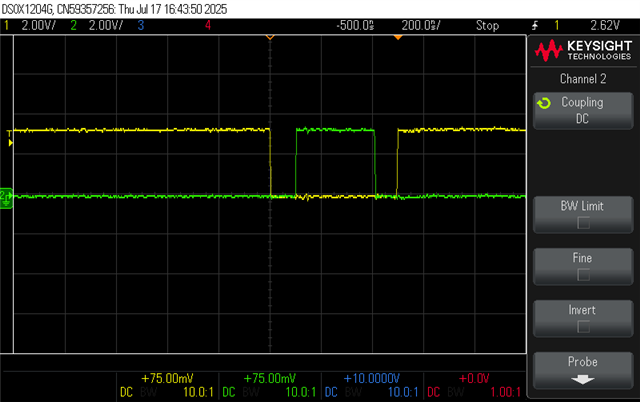

    PWM Input (Deadtime 100ns)
    • CH1 (Yellow) = LI - GND
    • CH2 (Green) = HI - GND

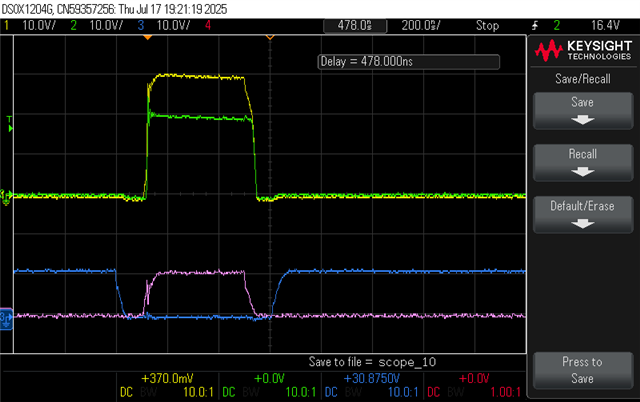

    Normal Pulse
    • CH3 (Blue)    = LO - GND
    Abnormal Behaviour

    - It seems like the Gate driver is somehow turning off. LO is staying low longer than the LI Pulse
    - The Supply Voltage at the VDD Pin of the Gate Driver is stable at 12V

  • Hey Lars,
    Thank you for the updated waveforms.
    This is an unexpected behavior and appears to be like a UVLO condition but with VDD pin being stable at 12V, that would not cause UVLO. Is HB-HS still dipping to 6V (below UVLO) during this condition? There is definitely some ringing on the outputs and this is likely due to overshoot and the lack of gate resistors.
