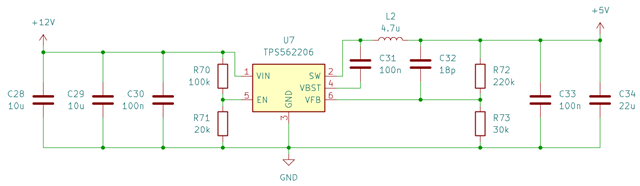

Could you please review the below schematic and layout for using a TPS562206? Input is 12V, output is 5V/1A.
We have 2 copies of this regulator on the board as we require separate outputs (one is fused with an eFuse, one is not).
I've omitted other parts of our board from the layout images, which is why the regulators appear laid out unusually. We've tried to follow the reference layout as closely as possible from the datasheet.
Schematic (both supplies are the same)

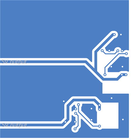

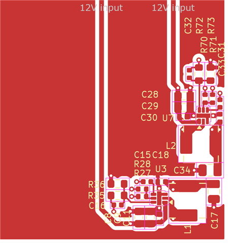

Layer 1
Apologies for the silk screen on this, we don't normally have one so I've just added a temporary one for the review.
