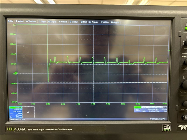

    Thanks for comments. For example, if NFET Rds(on) that we used is 11mohm.
    For the threshold for RCB would be -11mV/11m = -1A
    As you can see below, there was negative current initially. (-200mA) Does it mean LM74700-Q1 can't block the current?
    Roy
  • Hi Roy,
    Controller can block lower current as well due to linear regulation scheme.
    -11mV/RDS_ON is the max reverse current. Whereas due to linear regulation, FET may not operate at RDS_ON all the time.
    Shiven Dhir
  • Hi Shiven,
    Not sure the comments. Do you mean that it's the maximum reverse current would be happened?
    May you help comment more detailed?
    Currently, customer has initial negative current around -200mA and -150mA when doing load transient. We would like to check if LM74700 can block it completely or not.
    As I know, only VAC < -11mV, the MOS would fully turn off to avoid reverse current. Do you mean that the reverse current would be lower in regulated conduction mode?
    Roy
  • Hi Roy,
    Your understanding is correct. Reverse current will be lower in regulated conduction mode.
    Yes, -150mA or -200mA can also be blocked.
