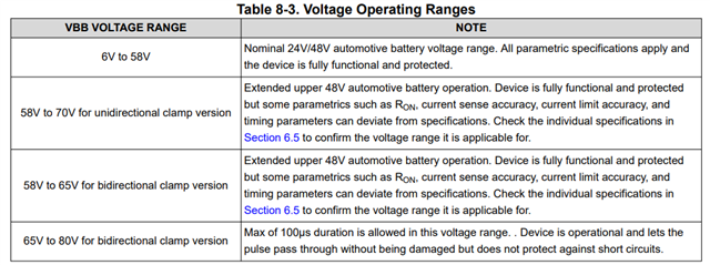

They want to use TPS482H85-Q1 with VBB=12V+/-10%.
Is there any performance change or concerning point?

    1. VOUT1 and VOUT2 can be tied together. This does not mean that each channel can handle more current than when VOUT1/2 have separate loads. It just means that a load that requires more current than one channel can handle can use two channels in a parallel configuration so that the current is split amongst the two. Please keep in mind the typical nominal load current per channel and how it decreases due to mutual heating when both channels are on.
    2. This device is designed for 24/48V systems because of its high voltage capabilities. However, you can still use it for a 12V system since it is still within the recommended operating range just make sure that at no point does it drop below the minimum supply voltage required.

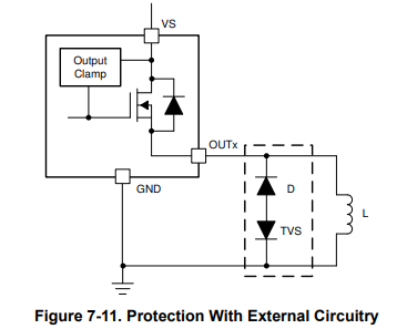

    The customer is considering using TPS482H85-Q1 to drive inductive load.
    In their case, the high side switch output voltage (VOUT) is pull down to -60.5V with 2ms width
    when the switch turns off from on. In this time, they apply 12V to VBB.
    In this case, is there any problem on TPS482H85-Q1?
    Is the voltage between VBB and VOUT too large?
    Thank you again and best regards,
    Kazuya.
  • Hi Kazuya,
    The VDS clamp will engage.
    If the demagnetization energy is expected to exceed what the device can safely dissipate, external circuitry must be used.
    Rishika Patel
  • Hi Rishika,
    Thank you very much for your reply.
    Could you tell me how to calculate the energy what the device can safely dissipate?
    Kazuya.
  • Hi Kazuya,
    I apologize but that data will not be available until the device is fully RTMed.
    Section 7.3.4 Inductive-Load Switching-Off Clamp in the datasheet and section 4 Driving Inductive Load in the following app note, How To Drive Resistive, Inductive, Capacitive, and Lighting Loads (Rev. E), show how to calculate demagnetization energy. We do not have the device limit data at the moment but these resources can give an idea of how to use that information when it is available.
    Rishika Patel

  • Hi Kazuya,
    Sorry for the delay. Yes, the TPS4H160-Q1 is already released but I was just pointing to an example that shows how to calculate if the device can handle the demagnetization energy depending on the load conditions; yes, it uses Figure 4-5 to determine if the device needs additional external circuitry or not.
    We expect that some sort of upper limit is defined, or graph is shown in the datasheet when this device is RTMed.
