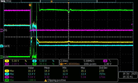

my customer side want to use LM25066 Vout short to GND experiment
but we find MOSFET is breakdown after doing such experiment

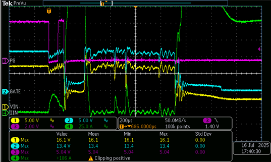

zoom in:
do think it's our hot swap wrong behavior? we have try to modify Ctimer and Cout. but doesn't work.
