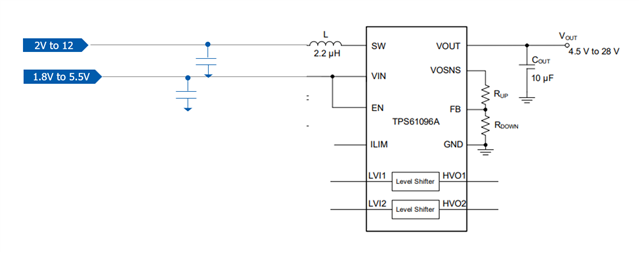

Hi team,
Our customer is looking for the boost converter supports below requirement. But the requirement of input voltage range is wide, so I expect if they can ready other supply rail for this device Vin, the separate input configuration like below can solve their requirement.
・Input voltage:2V to 12V
・Output voltage:max 16V/about 10mA
So, I want to know that if we can use TPS61096A with input separate configutration or not.
Please your opinion. And if you have other recommend product, please intoroduse to me.
