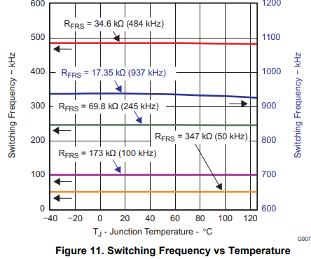

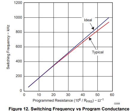

May I ask what is the minimum switching frequency for the TPS23756?
Hi Jacky,
TPS23756 can reach 50kHz at least. Let me know if you want a frequency lower than 50kHz.
