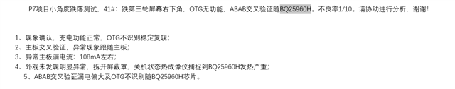

    During our experiment, an abnormality occurred: the OTG could not be recognized. After analysis and localization, we found that this issue is related to your company's chip. We need your assistance in further analysis. Could you please provide an address so that we can send the defective chip back to your company for inspection?

  • HI TI,
    The problems we have encountered are as follows:
    1. The experiment we conducted was a small-angle drop test. After the drop test, we checked the functions and found that the OTG function was abnormal, but the charging function was normal.
    2. We arranged a total of 10 machines for the experiment, and only one machine malfunctioned.
    3. After the failure, we found that the machine had a shutdown leakage current of 100mA. Therefore, instead of capturing logs and register values, we chose to use thermal imaging to troubleshoot the fault. It was found that the BQ25960H was overheating. We then conducted cross-verification and confirmed that the fault was associated with the BQ25960H.
    We have already contacted the corresponding FAE. Could you please help coordinate and push forward the further analysis?
