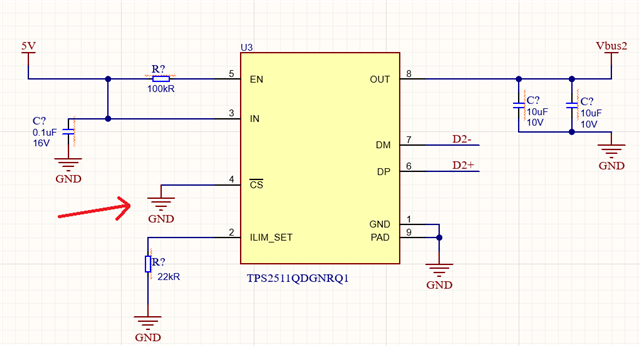

I don't want to use the CS pin, can I connect it directly to Ground?
best regards
best regards
Hi Omer,
The /CS pin is an open drain output, so connecting it to ground is not the optimum way to connect it when not used.
I suggest connecting it to the 100k pull-up that is shown in the datasheet, but then do not connect the CS pin to any other circuitry. This will offer the proper connection to the /CS pin, but no system impact.
Chuck
