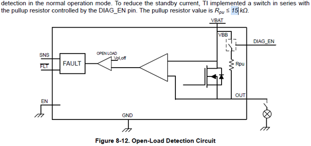

Hi expert
What's the minimum value of Rpu? The datasheet only show the max value of 15K.
I want to use this Rpu to distinguish open load and short to battery, with the external output voltage sampling.
BR
Linsong

Hi Linsong,
What data device are you asking this for?
the part number attached to this question is the TPS1HC30 but figure 8-12 for that device is
Nicholas Petersilge

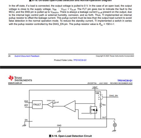

Hi Nicholas
I find the datasheet on my hand is not the latest one as below.
The pullup resister in datasheet online is 150KOhm. Is that correct?
BR
Linsong
Hi Linsong,
Correct, Rpu's value is 150 KOhms
