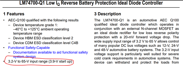

Hi Team
How to understand the description marked by red circle? this device will start to work at 3.9V, but it can support 3.2V-65V. this device can't work at 3.2V?
Hi Team
Hi Leo,
Device needs minimum voltage of 3.9V to startup, once started, it can work to voltages as low as 3.2V.
