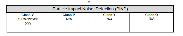

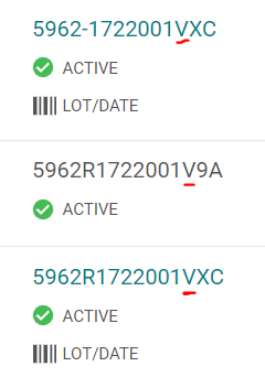

Could you confirm the orderable part number? If the OPN doesn't have the "V" as underlined in the picture below, it's not considered a QML-V part which means that we do not do PIND testing. Here's a document regarding the QML flow.
We do have a QMLV version of the LM185-1.2 that does go through PIND, and it can be found here.

Only "V" devices get PIND.
I cannot find the 5962-8405061VDA - please check the number.
