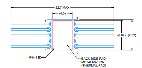

Hi, I was going through the spec sheet for this part, and noticed that the dimensions did not include the minimum lead to lead length. It does in fact show the maximum value of 22.7 mm, but could you please let me know what the minimum value is? Thank you so much.

    Based on newer drawings of our other ceramic packages used for space-grade power parts, it seems like a length tolerance of approximately 10 mil per lead would be a reasonable estimate. Typically the leads of our ceramic parts are trimmed and formed by the user after purchase. I assume this is likely the case for you as well. If that's correct, then it sounds like an estimate of the tolerance to confirm the total length is ample for your trim and form profile should be sufficient for your purposes since the leads would be trimmed anyways.
    Let me know if this information is enough for your purposes or if further help is needed.
    Sarah
  • Hi Sarah,
    Thank you so much for your reply. Yes, this does answer my question.
