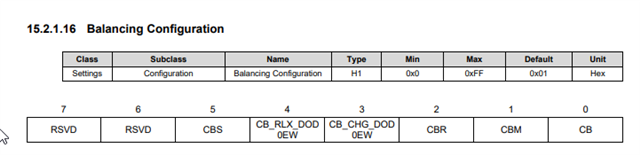

One thing I did notice is that the Balancing Configuration register is set to 0x05 so that CBR is set, but bit 1 is a RSVD_ONE and we are writing it to 0.  Could that be messing things up?
    Also, RSVD_ONE is 1 by default. Please change this back to 1.

    b) Will programming bit 1 of the balancing configuration register to 0 cause the system to misbehave?  We will try to get this fixed as soon as possible but would like to know the risk to our system with the current settings.

    Programming bit one of this register to 0 will disable cell balancing.
    Anthony
  • Anthony, thanks for your response, the DoD/QMax makes sense now.  With regard to bit 1 of the configuration register, my reference manual for bq40Z50-R1 is different than what you posted.  In mine, bit 1 is RSVD_ONE and it says to program it to 1 and not use it.  Through an error made years ago, this bit was actually programmed to 0.  I need to understand what the consequences of this are.  I can't simply program it to 1 as there are many packs in the field programmed this way already.  Will this cause any malfunction of the cell balancing operation?
    Ken
