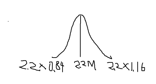

Let me confirm my understanding of spread spectrum of LMR60420-Q1. Its spread spectrum function spread the Fsw +-16% as shown below image, is it correct?

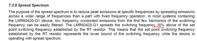

Hello Kento
Device spreads frequency above the set frequency. So, it would spread will Fsw to 1.16*Fsw.

Hello Onkar,
So, the Fsw frequency range with SS would be Fsw ~ 1.16*Fsw, correct?
