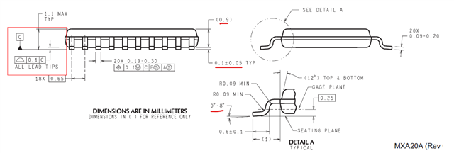

Hello team,
Can you let me know the exact tolerance for height and angle from the detail A?

Hi Austin,
The Max and Min of the package height is 0.961mm and 0.939mm.
