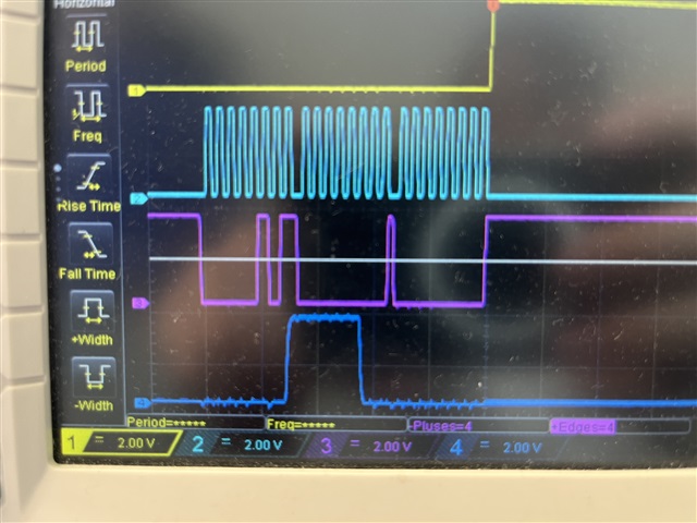

I have been trying to communicate with the Efuse via the onboard SPI pins using another Microcontroller as a master, and I get incorrect read data back from the Efuse registers. I have scoped the SPI commands, and they follow the specifications in the Efuse datasheet, but the data is coming back mainly as 0x80FF or 0x00F8, no matter which register I read from.

  • I am using an ATSAME54P20 microcontroller that is on a SAME54 curiosity dev board. The phase is data sampling on a leading SCK edge and changed on a trailing SCK edge. The polarity is SCK is low when idle. The clock frequency is 1MHz
    This is a snippet of my code

    The GPIO is the CS pin.
    Here is also a photo of my osciliscope. The first wave is my CS pin, the second my SCK, the third my SDI, the fourth my SDO
    Thank you for helping me with this

    SPI mode 1 (polarity 0, phase 1) is the correct setting.

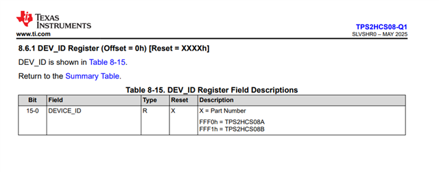

    I think maybe what is happening though is that the register reads do not populate on the same transaction... meaning the payload for the the register that you request is populated into the register and available on the subsequent read request. We do this to allow for management of reading in SPI daisy change configurations where there are multiple HCS devices setup in series. Could you try reading register address 0x00 twice? The second transaction, for the payload, you should be getting the device ID:
    If needed, I can capture a logic trace later today if you are still not able to get it to work.
    Tim
  • I changed the phase and now the Efuse sends the correct data out for the reads, thank you
