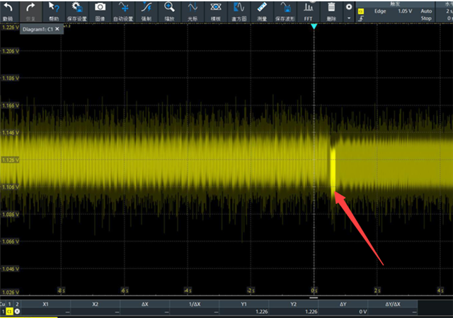

The first configuration is :
3.6V Input voltage/ 1.1V Output voltage, The LDO output is 0.87V, around 300mA average output current, 600mA maximum output current.
10uF of LDO input capacitance and 70uF LDO output capacitance.
They use 12cm coaxial cable (5mOhm resistance) to connect Buck and LDO.
Transient resposne:

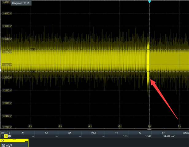

the first configuration is :
3.6V Input voltage/ 1.3V Output voltage, The LDO output is 0.87V, around 300mA average output current, 600mA maximum output current.
Waveform:
