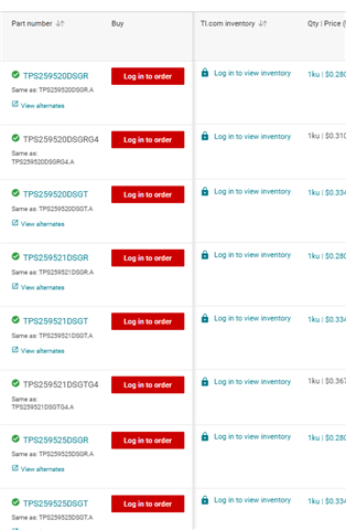

HI TI team,
We would like to order TPS259531DSGR.A instead of TPS259531DSGR but the websit shows that TI only allows to order TPS259531DSGR,
Please help to advise how do we identify the material contain with A version? Thanks

Hi Yi Yi Chen,
There is no .A variant for this device. By default this device is fabricated in US, but I need to confirm on this.
I will get back to you on this on Monday since it is already Friday night and I will need confirmation from my colleagues.
Arush

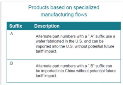

Hi Yi Yi Chen,
I checked with the team. All the TPS2595 die are fabricated in US so by default it is .A device. So you can just order the devices directly. If you check the ti.com info, you will realize that it mentions and these devices are same as .A variant.
