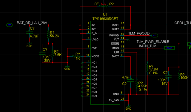

Hi Team,
I have a technical question about TPS16330 component configuration.
In one of the designs I have seen the OVP pin to GND.
I could not locate in the datasheet an explanation of what is the OVP threshold when this pin is grounded.
Could you please explain?
  • Hello Ohad,
    A voltage more than V(OVPR) on OVP pin turns off the internal FET and protects the downstream load.
    OVP pin connected to GND will never make the voltage go above V(OVPR). Thus, OVP will be disabled.
    Amrit
