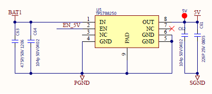

Hi Team,
Please help command TPS7B8250 schematics, thanks!
Vin: 9~16V
Io:1A
  • Hi Kevin,
    If significant series resistance or inductance is present between SGND and PGND, the output capacitance should connect to PGND instead of SGND to ensure the LDO remains stable.
