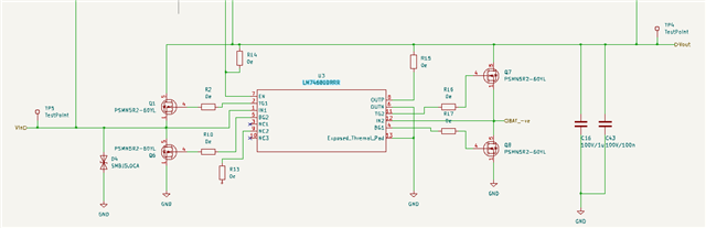

Hi team,
I am using the LM74680 for DC with
  • Reverse polarity on input (Vin)
  • reverse current prevention (from Vout to Vin)
  • Vin input short circuit protection
Both Vin and Vout are meant to used are a 48V Li-ion battery pack.
While testing, I find that I am able to discharge via Vout
Please let me know what I am missing. Schematics are attached.
