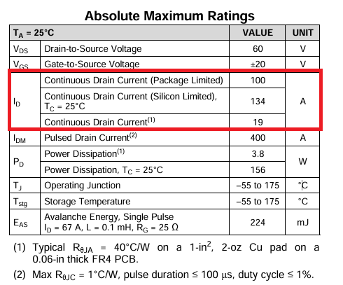

CSD18531Q5A: Query on the Steady state current to be considered
Part Number: CSD18531Q5A
The absolute maximum rating of datasheet mentions three currents - silicon limited, package limited and continuous drain current, Which one is recommended by TI for considering for worst case circuit analysis and derating evaluations?
  • Hello Vinaya,
    Thanks for your interest in TI FETs. Please see the blog at the link below for a more detailed explanation how TI specs maximum continuous current for our FETs. The package limited current is self-explanatory and the other two ratings are calculated as explained in the blog. Power dissipation is also an important consideration. The 5x6mm SON package can dissipate about 3W max with a good layout on a multilayer PCB. The second link provides max power dissipation for TI FET packages. Please review and let me know if you have any questions.
    John Wallace
    TI FET Applications
    https://www.ti.com/lit/pdf/ssztcp0
    https://www.ti.com/lit/pdf/sszt389
