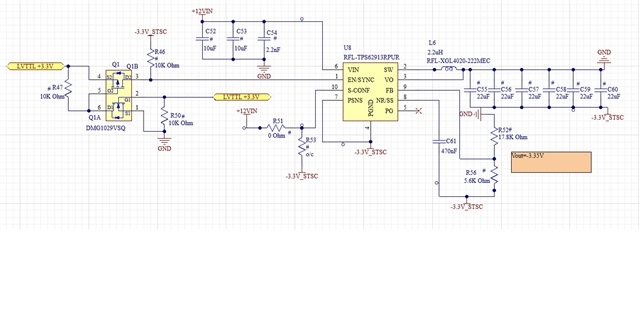

TPS62913: TPS62913 inverting schematic
Part Number: TPS62913
Would need help to verify that the schematic for the inverting configuration is correct as the software does not have inverting configuration.
Intended paramters
2.2MHz with spread and output discharge off.
Vin=12V
Vout=-3.35V
Enable pin=+3.3V LVTTL signal
