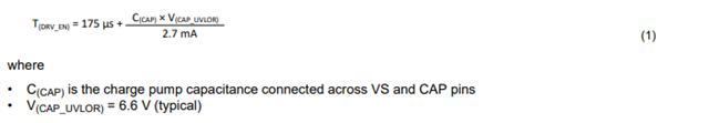

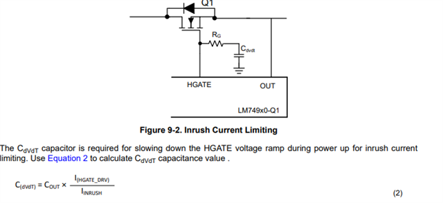

Hi Team.
I see below figure in datasheet. I would like to check how to calculate/estimate the duration of below arrows?
If condition is swapped. The Start-Up EN('H') with 12V Going Low to High, I would like to check how to calculate/estimate the Vout buildup time.
