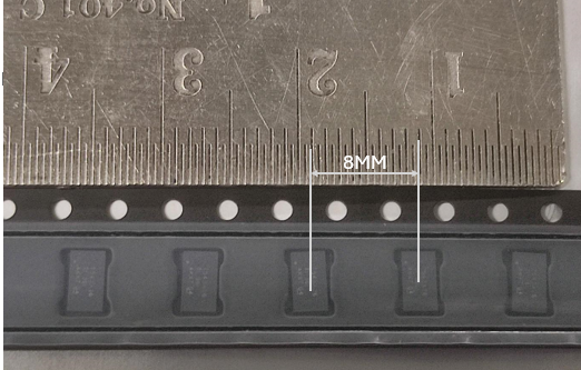

Found that the pitch is different against the data sheet:
Actual Pitch: 8mm, Data sheet Pitch: 4 mm. Pls refer the attached presentation for reference
.Ciena_CIE-035-5251-001_TI_TPS543A26RYSR_Pitch Issue.pptx
Kindly advise.

We appreciate your attention to detail regarding the TPS543A26 tape pocket pitch.
We would like to clarify the difference you've noticed between the parts you received and the current datasheet specifications.
The parts delivered to you in August 2023 were manufactured according to the specifications in place at that time, which used a tape pitch of 8mm.
However, in May 2025, we implemented a change to our manufacturing process and updated our datasheet accordingly.
The current specification now indicates a tape pitch of 4mm.
This change represents an improvement in our packaging process, allowing for more efficient use of materials.
However, we understand that this change may impact your manufacturing or handling processes.
To summarize: - Early build (delivered in 8/2023): 8mm tape pitch -
Current build (as of May 2025): 4mm tape pitch
We apologize for any inconvenience this change may cause.
