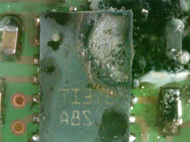

But once the TPS923655DMTR burned off by following conditions:
  • 24V (DC supply Imax 10A)
  • low resistance supply wires (2,5 mm2 / length 1m)
  • the LED driver immediately starts after power ON
  • I_led = 1A
  • U_led = 28V
Unfortunately, I connected the supply wires (laboratory plugs) too slow, so I got some voltage bouncing. I heard sounds like ringing / cracking noise.The boost regular was not stable and the TPS923655DMTR burned off. Maybe my DC supply and the TPS923655DMTR were swinging in phase (positive feedback). It took only approx. 1-3 seconds. Then the LED driver was dead.
Has anybody comparable problems?

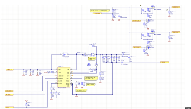

  • Dear Lucia, Thanks for your answer!
    My project consists of nine schematic pages.
    I’m aloud to post them all. Here is the schematic part of one my boost regulators.

    Maybe the components at CSP, CSN and COMP in our schematic had to be change (value). Until now we saw no electrical problems.

    Please review my schematic, maybe the COMP components, Csense or so can be improve.

  • Hi Kai,
    Could you pls send email to lucia-gao@ti.com? I can share with you the EVM schematic of TPS923655 and I also have several suggestions of the schematic above. Thank you!
