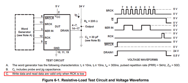

I am reaching out regarding some recent issues we have encountered with the following lots of the TPIC6B596DWR component: 3CAF8HT, 3CAF8GT, 42A1EST, and 37DX83T. These components were previously functioning normally but have now presented unexpected behavior.
Upon investigation, I identified two important updates communicated by our IT and engineering teams:
  • PCN #20221013001.2 (October 2022): This Product Change Notification outlines a migration to the DMOS6 process with 300 mm wafers, a change in bond wire material from gold (Au) to copper (Cu), and modifications in the package construction—although no changes in form, fit, or function were officially declared.
  • Updated datasheet (Rev B – SLIS095B, March 2025): This revision maintains key electrical specifications (such as rDS(on), voltages, currents, and temperature range) but introduces editorial updates and revised notes.

    May I know what's your recent issues and could you share more details about the unexpected behavior? do you have any test waveforms?
    "I am reaching out regarding some recent issues we have encountered with the following lots of the TPIC6B596DWR component: 3CAF8HT, 3CAF8GT, 42A1EST, and 37DX83T. These components were previously functioning normally but have now presented unexpected behavior."
    I assume that you already have two PCN documents, the PCN2022 is related to the FAB change due to the process update, and the PCN2025 is related to the clarification of application details.  Please refer to below timing diagram, for the samples from the new FAB, please follow the recommended timing diagram. Many thanks!
