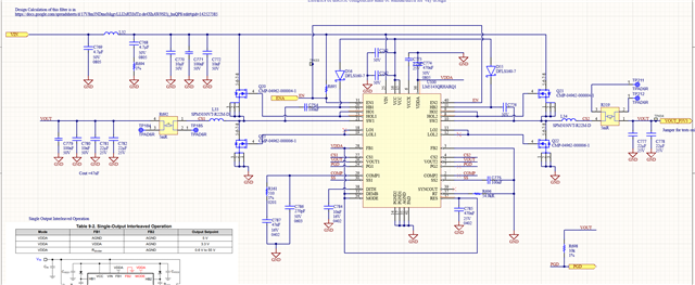

LM5143: LM5143A - 2P/3.30V/~15A Looking for simplis model, and comment on design. Vout is expected 3.30, but actual=2.517V
Part Number: LM5143
Other Parts Discussed in Thread: CSD18563Q5A,
Looking for simulation model for this part, SIMPLIS, TINA, PSPICE (the cadence pspice, not the TI version if we go this way)
Coworker made this for me, it's in the board now, - there are a couple mods in the schematic as noted after the picture
IE RT is 10K not 54.9K as shown
HO1/HO2 left out the 1-2 ohm
C785 looks like Cres, but it's just VDDA tied to RES
Ignore ENA offpage, itt goes nowhere
strapped to be 2 phase 3.3, f=2.1 MHz
VCCA = ~ 4.89V
VCCX = not connected (tried adding 5V here )
Ton=78
Toff=401
(approx)
On both 1 and 2 sides
hiside fet is CSD18563Q5A
lowside    is CSD18543Q3AT
Choke is SPM5030VT-R22M-D TDK , 0.22u, Isat=21

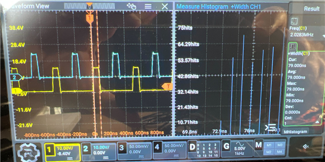

sw nodes look reasonable, but seems not closing loop to 3.30V vout
Vout measures approx 2.517v, w 20mV p-p
load is minimal at the moment (below 100mA)
Vin = ~ 13.79V
