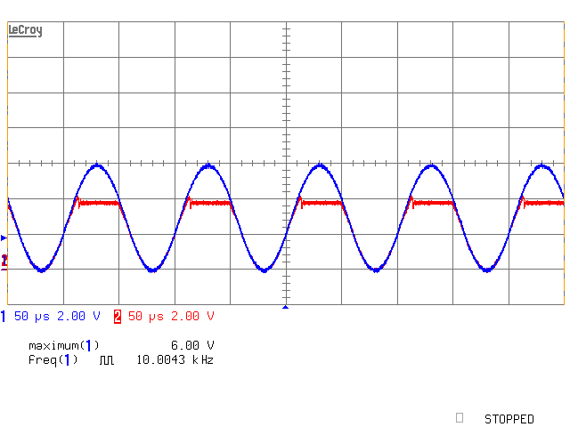

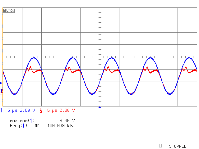

  • I tested my circuit on a breadboard with a generic (not TI) TL431 I happen to have on hand. This is what I got. At 10 kHz, it looks good to me, but seems to be unusable at 100 kHz. I just found that working up to 10 kHz is good enough for me now.
    So TI branded TL431 or variants would not perform too differently, right? What are some proper ways to implement a clipper/clamper circuit if I want higher frequency later?
