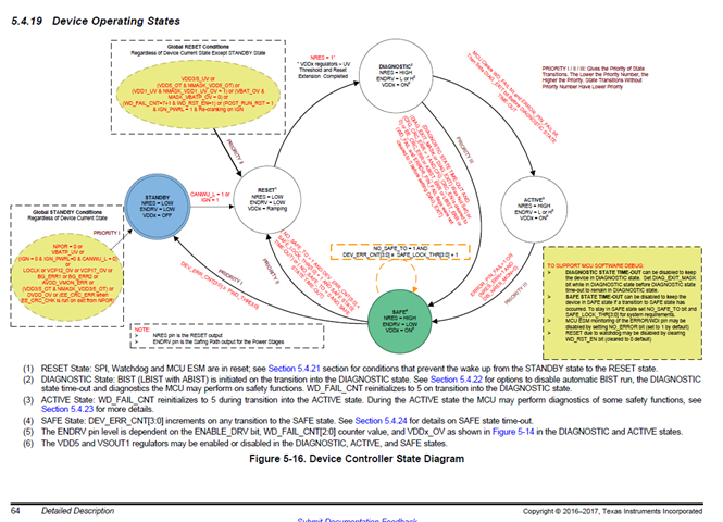

I understood we don't have reference code. is there any flow chart to bring up this PMIC? or state machine to read/write by SPI?
Hi Luke,
There is a diagram in the datasheet
By default, the PMIC will eventually settle into the Safe state. The PMIC can only be configured when in the diagnostic state. You can stay in the diagnostic state by setting the diagnostic state mask. After completing configuration of the PMIC you can then transition to the active state.
