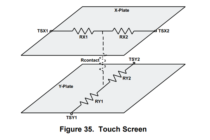

I don't understand the difference between the value of “Plate resistance”, the value of “Resistance between plates contact” and the value of “Resistance between plates pressure”.
What is the definition of each?

    Plate resistance is referring to the resistance along the X or Y direction.
    Resistance between plates contact/pressure is referring to the resistance in the Z direction, between the two plates (R_contact in the diagram below),
    This is used to measure the pressure on the touch screen. Contact and Pressure should mean the same thing in this context.
    The resistances of your touch panel fit within the specs of the X and Y plate resistances, so this will be fine.
    R_contact is typically calculated depending on the pressure applied to the screen, this may not be explicitly listed as a spec for the touch panel.

    The minimum value for plate Y is 200 ohms, but the minimum value for this touch panel is 183 ohms.
    Is this a problem?

    If the resistance value is not enough, can it be compensated by adding a series resistor or other means to make it work without problems?

    A series resistor can be added to meet the impedance requirement. Meeting the minimum requirement will the reduce noise on the XY lines for a more accurate trigger/touch registered with the TSC device you choose.
