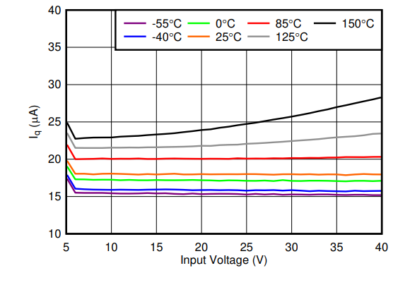

  9. Can you please provide the data of Current Consumption vs Output Current @VIN = 13.5V for new chip.
  10. Can you please provide the data of Current Consumption vs Output Current @VIN = 36V for both legacy & new chip.

    9. See Figure 5-16
    10. Data for legacy chip is not available. New Chip Iq should be similar to this:

    9. I am unable to see the curve you have shared in previous reply. Can you please share the datasheet from where you have referred this curve. Please find the below link of datasheet that I am referring. In this current consumption available only for legacy chip. Can you please check

    Unfortunately, I'm unable to share the source datasheet, only the curve itself. A link to the image file is here: pastedimage1753218929606v1.png (580×414)
