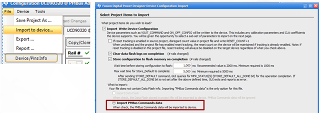

Is there a good method to migrate the XML File from UCD90160 to UCD90160A without loading onto a UCD9016A device.
We are migrating our designs and do not currently have a board with the UCD90160A installed.
Mark Rae
  • Hi, Mark,
    Whenever you have the UCD90160A board, you can use Fusion GUI to import the project file to UCD90160A device. Select "Import using PMBus Command data".

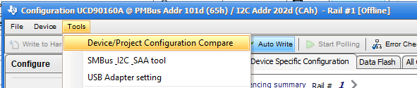

    I need to create a UCD90160A configuration before I receive the Board.
    Is there a way to migrate the XML file before I have the board?
    Mark
  • Hi, Mark,
    There is no easy way, but there is a way to do it, manually and time consuming.
    • Launch UCD90196A offline device GUI: On Fusion GUI main window, click on "Build System" button, then select "Create new offline System from start". Click on "Select Device" button, then select UCD90160A device. Click on Finish => GUI starts with UCD90160A device in the system.
    • On GUI main GUI, click "Click to configure device" to launch UCD90160A device GUI.
    • Do project/configuration compare by click "Tools menu" ->Device/Project Configuration Compare.

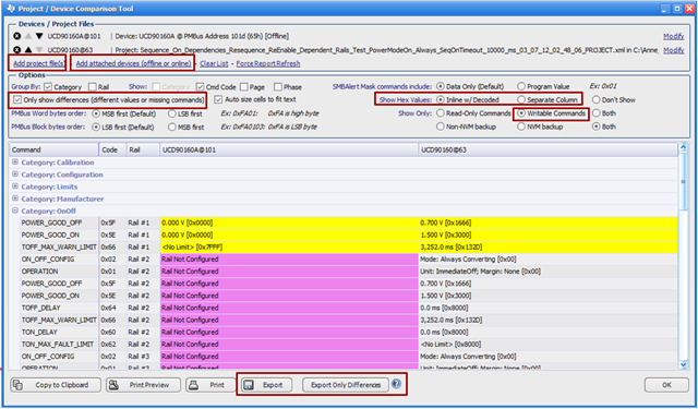

    • Click on "Add attached device..." to add UCD90160A. Then click to "Add Project file" to add your UCD90160 project file
    • Select "Only show differences", "Writable Commands" only, "Show Hex Values"
    • You will see the differences between the two configurations. Select "Export Only Differences", and then manually make changes to UCD90160A device.
