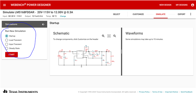

Is it possible to simulate a LM5168P design in Webench?
Please provide a link or explain how to do this.
When I attempt to simulate LM5168P it uses LM5168F. These parts behave differently.

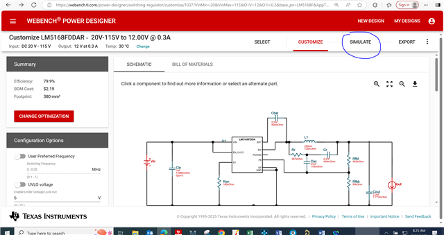

Hello Bruce,
Yes, we have basic simulation profiles on WEBENCH enabled for this device. please click the areas highlighted below in WEBENCH domain to sim.
Hope this helps.
David.
David,
These images show simulating LM5168F, not LM5168P. These parts behave differently.
Hello Bruce,
WEBENCH is a basic simulator. if you need to simulate light loads, suggest downloading the PSPICE model and using PSPICE for TI. Thanks.
