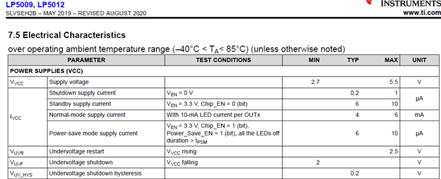

    If not, recommend to take a look at the LP5009, which support shutdown mode with 1uA current and power save mode (when all channels are off) with 6 uA current.

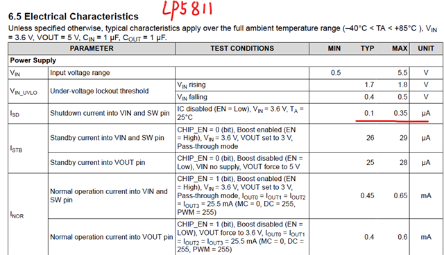

    • We considered the LP5811, which is a nice chip indeed, but shutdown there can only be achieved by an extra line (EN), which we do not have available. The standby current (26uA) is too high for our purposes.
    • The LP5009 is an interesting solution we did not yet consider, indeed since it dropped out of our filter because of having more channels. This chip also requires an extra line to go to shutdown mode, but the power save mode looks better here, with ~6uA. Formally, it exceeds our design requirement for an inactive chip so this has to be discussed.
