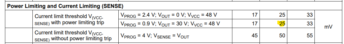

The datasheet on page 3 states that the current limit threshold voltage with "power limiting trip" is 25mV

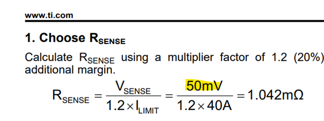

However the Application Design Example on page 20-24 uses 50mV for the calculation of Rsense despite being power-limited:

  1. What value (25 mV or 50 mV) should be used for current limit threshold in power-limiting mode?
  2. How to definitively determine whether the design is operating in power-limiting or current-limiting mode?
  • Thanks for reaching out.
    Current limit threshold V(VCC-SENSE) with power limiting trip means that the device is in power limit. Please see the test condition, VDS = 48V in one case and 18V in another case. When the device is in power limit condition, the current flowing through the RSNS will 25mV/RSNS.
    Current limit threshold V(VCC-SENSE) without power limiting trip means that the device is in current limit. Please see the test condition, VDS = 0V. When the device is in current limit condition, the current flowing through the RSNS will 50mV/RSNS.
    Green Circle: Current Limit
    Blue Circle: Power limit
