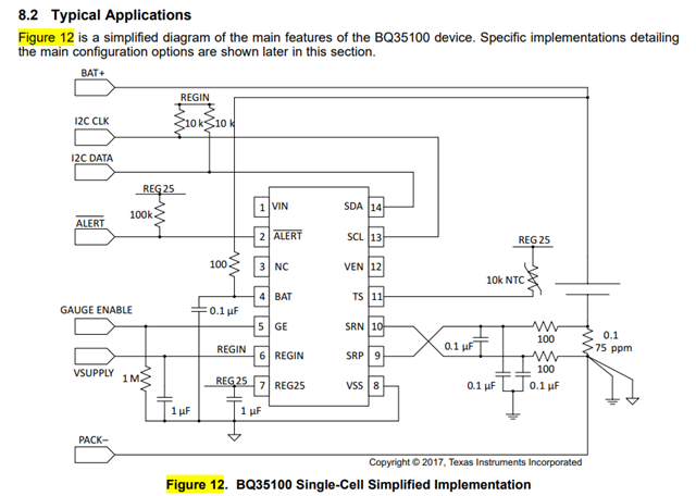

2) Pull-up destination of ALERT pin
According to Figure12 in the datasheet, ALERT pin is connected to REG25 (2.5 V internal LDO output).
According to the specifications of ALERT pin in Pin Function, it is described as an open drain output.
If it is an open drain, I am thinking of using external power supply (REGIN input) as the pull-up destination. Is there any problem?

    1) no issue
    2) this should be ok
