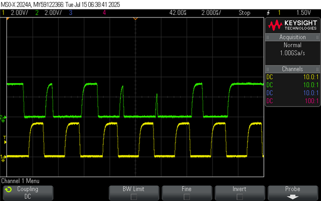

(1) SDA glitches
While the communication appears to be working correctly, my scope/logic analyzer are showing unusual "glitches" on the SDA line. These glitches are very short pulses that occur between the SCL clock pulses, specifically when the SCL line is low. SDA signal appears to be stable during the rising edge of SCL and these glitches appear to not occur when SCL is high.
Question: are the glitches expected and harmless?

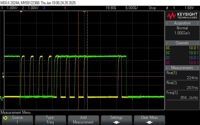

(2) Lower than expected clock frequency
I consistently measured the SCL frequency to be ~355kHz, which is lower than the expected 400kHz. The datasheet doesn't clearly specify the expected frequency tolerance. As mentioned above, the differential I2C link is configured to 500kHz, while host MCU to 400kHz, suggesting they are not the bottleneck.
Question: is it expected that the actual BQ76972 SCL frequency is 355kHz when the device is configured in 400kHz I2C fast mode? If not, would you suspect the lower frequency to be caused by the host/diff I2C link?

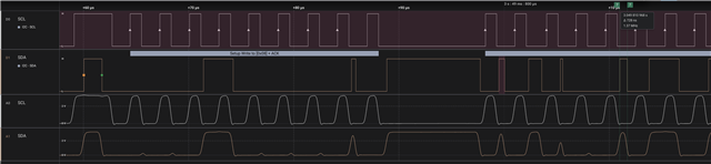

(3) Excessive clock stretching
I am observing significant clock stretching when communicating with BQ76972 over I2C at 400kHz, which is substantially impacting my bus throughput. As shown in the attached logic analyzer capture, the device holds the SCL line low between bytes for periods that are often longer than the time it takes to transmit an entire byte, effectively doubling the transmission time.
Question: Is this aggressive clock stretching considered normal operating behavior for the BQ76972, or could it indicate an issue with my setup?

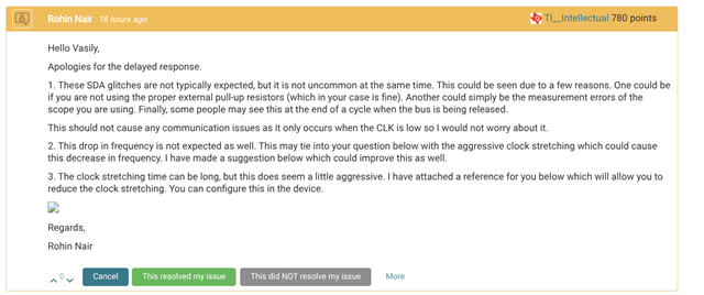

  • Hello Vasily,
    Apologies for the delayed response.
    1. These SDA glitches are not typically expected, but it is not uncommon at the same time. This could be seen due to a few reasons. One could be if you are not using the proper external pull-up resistors (which in your case is fine). Another could simply be the measurement errors of the scope you are using. Finally, some people may see this at the end of a cycle when the bus is being released.
    This should not cause any communication issues as it only occurs when the CLK is low so I would not worry about it.
    2. This drop in frequency is not expected as well. This may tie into your question below with the aggressive clock stretching which could cause this decrease in frequency. I have made a suggestion below which could improve this as well.
    3. The clock stretching time can be long, but this does seem a little aggressive. I have attached a reference for you below which will allow you to reduce the clock stretching. You can configure this in the device.
    Rohin Nair

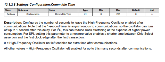

  • Hello Vasily,
    Apologies. I have attached it again below. If this does not work, you can also view this in Section 13.3.2.8 of the TRM.
    Rohin Nair
  • Hello Rohin,
    I forgot to mention in my original message, I've already configured this setting to the maximum value of 255 for the comms timings reported above. Would you have any other suggestions for further investigation?
