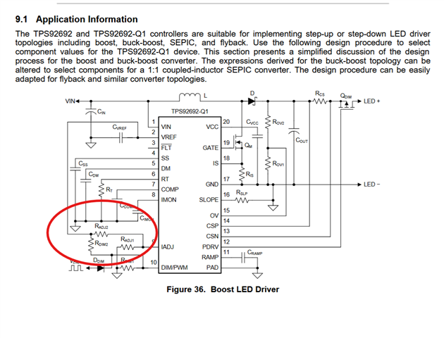

  • Hi Daniel,
    Is it possible to use the IADJ pin (resistor divider) to set a current limit, while using the DIM/PWM as PWM input? If not, what other ways do I have for implementing current limit? I'm not asking from a measurement standpoint, I think IMON pin can do it. But, I want to control the current actively.
    Jagan
    yes you may
    FYI this is on page 25 of our data sheet.
    Varying the IADJ voltage is how you would control the current actively.
    However,  you would set the current limit elsewhere:

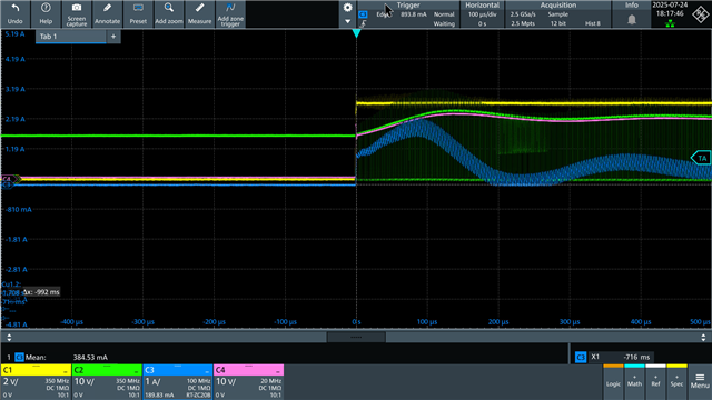

  • Hi Daniel,
    We have purchased the TPS92692 EVM for testing and validation. Initial tests with the default components showed no delay in response to PWM, which is great news. Now, I am attempting to scale up the output power, as you previously mentioned it is possible to operate up to 140W.
    So far, I have made the following modifications:
    • Removed R21 to set VIADJ to maximum, allowing maximum LED current.
    • Changed RCS to 0.1 Ω.
    • For testing, I am using a 12V/20A power adapter at the input and a 15 Ω resistive load at the output.
    Based on calculations, I expect approximately 1.7A through the 15 Ω load, resulting in about 27V output. However, the output voltage only rises to 12V and then drops. I have tested this with both hiccup mode enabled and disabled (via J4), but the behavior remains the same.

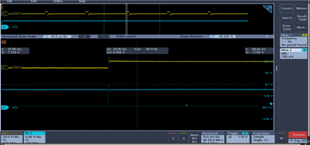

    Additionally, I noticed that the VCC pin voltage of the LED driver drops when PWM is applied. I’ve attached image for your reference.
    Could you please advise if any other changes are needed on the EVM to achieve the desired output? Since you mentioned you’ve conducted similar tests before, it would be very helpful if you could share any reference images or data so we can better understand what to expect.
    Jagan

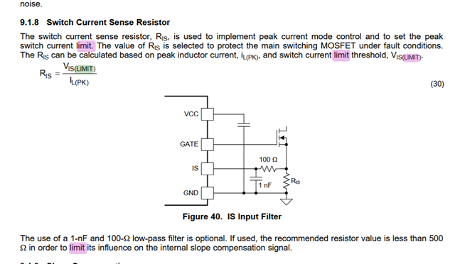

  • Hi Jagan,
    Can you please open a new thread since this is a new topic?
    You also need to change RIS... you are probably hitting over current protection. Please use our calculator tool to determine the recommended values for your use case.
    This drop in VCC is negligible, please familiarize yourself with the faults and diagnostics section of the data sheet to help you diagnose and solve your issues.
