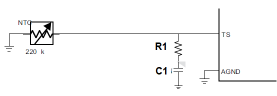

TPS61311: Maximum allowed capacity on the TS pin
Part Number: TPS61311

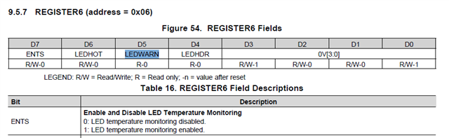

The datasheet states that a 220k NTC thermistor should be used. Additionally, the thermistor bias current is specified at 23.8uA.
Since the bias is only activated when, for example, video light mode is enabled, the voltage on the TS pin begins to rise at different rates depending on the capacitance.
If the voltage rises too slowly, the low voltage is detected as a temperature error.
Since it is not specified when the first temperature measurement is taken, no conclusions can be drawn from the datasheet regarding the maximum allowed capacitance.
Are there any other notes or recommendations regarding the maximum capacitance on this signal?
