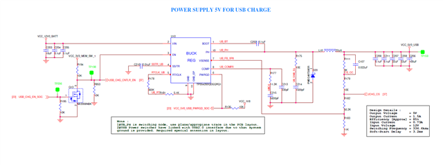

Hi Team,
We are currently facing a CISPR 25 Class 3 CE compliance failure. During testing, we observed that the failure frequencies are directly correlated with the switching frequency of the TPS54260QDGQRQ1, which operates at a switching frequency of 336 kHz.

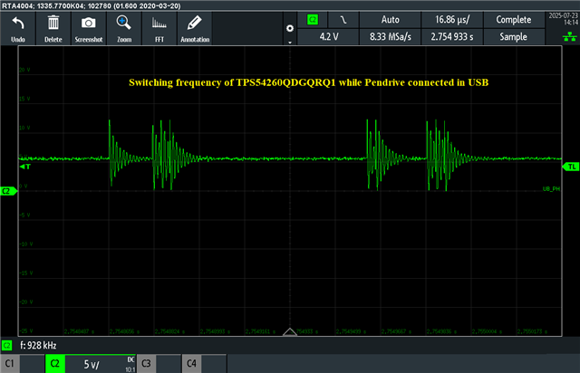

Further investigation revealed that when a USB pendrive is connected—drawing less than 5 mA—the TPS54260QDGQRQ1 enters pulse skip mode. We suspect that this operating mode is causing the emissions that lead to CE failure.
Our customer requires the system to pass CISPR 25 Class 3 testing even when a USB pendrive is connected. Could you please advise us on how to resolve or mitigate this issue?
