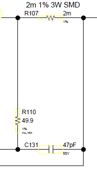

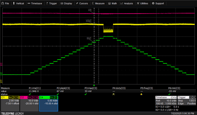

The LM5149 reaches its power limit at a load of 20A.
- input : 54V
- output : 12V
I designed the LM5149-Q1 according to the attached quick design guide excel file.
QuickstartDesignGuide
I added R(49.9)-C(47pF) filter to the current sensing line(ISNS+ to VOUT).
How can I modify design to reach 20A load at 60Vmax condition?
Thank you
  • Hi Ben,
    The current limit is set at max output current + Inductor ripple - thumb rules is to set ~140% of max current - therefore, try to set OCP at ~28A for 20A design. The recommended sense resistor will be 1.8mOhm.
    The inductor value is also a bit too low in your design.
    Taru
