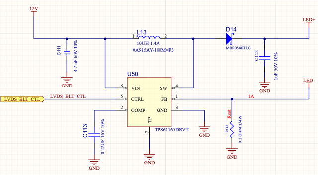

We are using the TPS61165 for brightness control to drive a 12 V, 1 A LVDS display. We have designed the schematic—could you please review it and share your valuable feedback?
Also, please check the Schottky diode selection. Our requirement is 12 V at 1 A, but the diode currently used is rated for 500 mA. Do we need to replace it with a higher-rated part?
