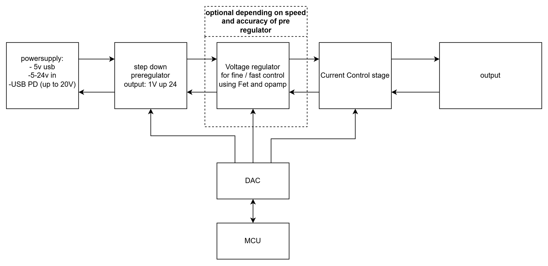

    Technically speaking, it may be possible to modulate your output voltage with a signal on FB. The biggest issue I see however is your inductor current ripple would vary wildly, and care will need to be taken to ensure that you are not putting your device into an unstable condition.
    Can you please share a block diagram of what you are attempting to accomplish?
    Thank you,
    Joshua Austria
  • hi joshua,
     this is the block diagram of the system i want to create.
    the goal is to make a mcu controllable current and voltage supply that can be used to test embedded systems. the system will also allow to measure the voltage and current at the output so you can do things like powerprofiling of low power stuff. the reason for the current supply is that i also want to be able to do things like testing LED's.
    the part i want to use the buck converter for is the step down preregulator. since i dont want to choke all power through a FET.

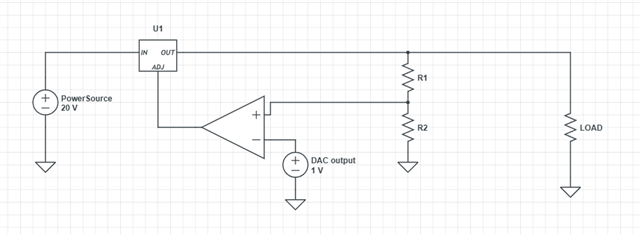

  • according to Reddit something like this could also work. can you confirm this? also if you would suggest some other buck converter that is totally fine. as long as it can meet my specs and is not very expensive it's oke.
  • Hi Thomas,
    Is this circuit essentially modulating the voltage that the feedback pin receives? This could also be doable with a circuit that modulates either the R1 or R2 resistors such that the setpoint for VOUT varies.
    As long as the feedback pin voltage is not forced past its absolute maximum rating of 25V, this should be ok. Please keep in mind however the caveats as noted previously.
    Also please ensure that you are utilizing the adjustable output voltage versions of this device.
    Thank you,
    Joshua Austria
