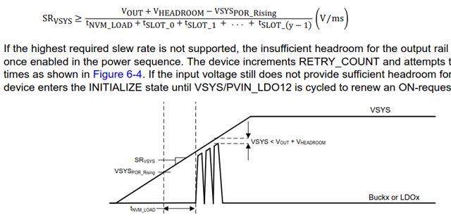

I just try to calculate the input slew rate for the PMIC. But I am kind of struggling to find everything. According to the datasheet you should be able to calculate it with this formulas:
The V_HEADROOM can be calculated with the formula in the figure. But I really can't find the value for VSYSPOR_Rising. I also searched in the NVM datasheet, but can't find anything.
Or is this not about calculating rather measuring?
And am I right, that I need to calculate it for every output, and then find the worst case in order to determine if my input slew rate is in spec?

    VSYSPOR_Rising is not explicitly stated in the datasheet, but this is typically 1.8 V - 2.275 V. I would use an average value of ~2.05 V here for calculations.
    I would run the calculation with your expected output voltage for each output rail in your use case and check that this is within spec.

    Do you also have a time for t_NVM_LOAD? I would have thought this should be also in the NVM datasheet, giving the name.
    Yes, thank you for the feedback, I agree, we will look into adding these in the next revision of the datasheet.
    t_NVM_LOAD is 4.95 ms (max).
    This is the time that it takes the NVM to load to the device, so it isn't necessarily NVM-specific.

    Thanks a bunch, this should help to calculate it.
