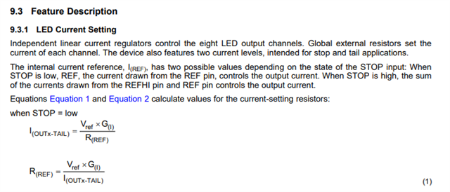

I am interested in using LM3409 as a LED driver for my Project. I want to use an appropriate potentiometer on Iadj pin to control brightness of LEDs. I have total of 32 white LEDs and 12V supply voltage. Forward voltage of LED is 3.1V and Forward current is 20mA. I am planning to use 3 series-11 parallel LEDs combination. I cant use more than three LEDs in series due to input voltage limitation. Is this design feasible? If I can implement this design then how can I calculate value of potentiometer, selection of mosfet and Indutor?

    You cannot drive LEDs in parallel because of part-to-part variation in I-V curves. Essentially, placing LEDs in parallel means you cannot control the current and there will be significant brightness variation between LEDs in the string.
    Why are you looking at a switching regulator for 20mA? LM3409 is used for designs up to about 5A. At 20mA you can achieve this with a linear regulator that has multiple output channels.
    Use 2x TPS92638-Q1 with 3x LEDs per channel. Use five 3-LED strings for each device plus one more 2-LED string to spread the power. You can control the brightness with PWM dimming or with the reference pin resistor.

  • only reason to select LM3409 was because it has option to control dimming using potentiometer. Can I use potentiometer with TPS92638-Q1?
  • I tried to read datasheet of TPS92638-Q1 to figureout how to setup potentiometer for dimming control but I could not figureout what value of potentiometer should I use and how to setup schematic for that. can you guide me with some refference design or just explain how  i can connect potentiometer to the IC for brightness control?
  • Hi Zunuran,
    Please refer to section 9.3.1 of the TPS92638-Q1 datasheet.
    The current for all channels is controlled by the reference resistor. You can use equation (1) to determine what value potentiometer you need to use for your reference resistor.
