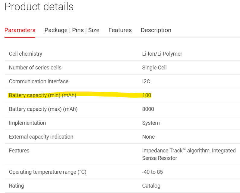

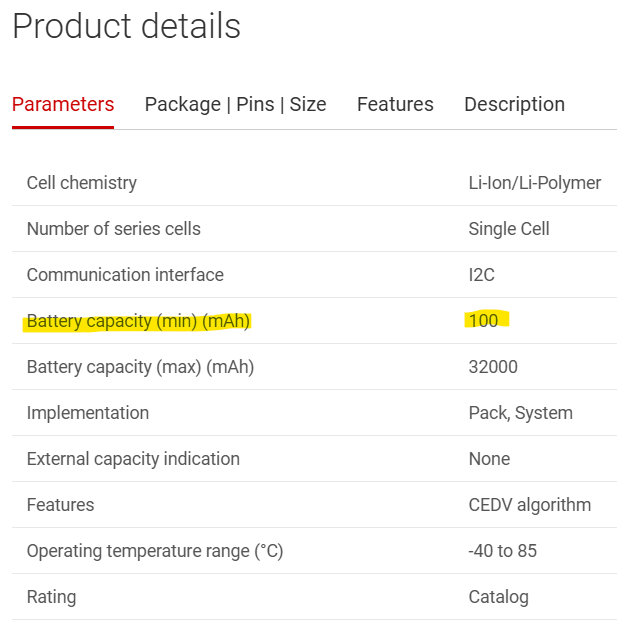

A customer has an inquiry about the battery capacity and accuracy of BQ27220 & BQ27427.
While reviewing BQ27220, I confirmed that the battery capacity is 100mAh as shown in the picture below, and I could not set the value to less than 100mAh when applying the filter.
Q1) The customer wants to use a 50mAh capacity battery. Can we use BQ27220? Is there any problem?
Q2) BQ27427 is also marked as Battery capacity(min)=100mAh, but can I use a battery capacity of 50mAh?
[BQ27220]
[BQ27427]
Unlike BQ27220, BQ27427 does not require compensation and has a built-in current sense resistor, so it seems better to apply. However, if there is no significant difference in accuracy due to the unit price difference, I would like to apply BQ27220.
Q3) Can you tell me how much of a difference in accuracy there is between BQ27220 and BQ27427?
Please check. Thank you.

  • Hello Grady,
    Both the BQ27220 and BQ27427 require a minimum of 100 mAh, so a 50mAh battery would not work for these gauges.
    BQ27220 use CEDV, while BQ27427 uses a much more advanced gauge algorithm called Impedance Tracking. Impedance tracking offers much better accuracy compared to CEDV as it can properly estimate internal resistance of a battery as it ages. BQ27427 will be much more accurate compared to the BQ27220.
