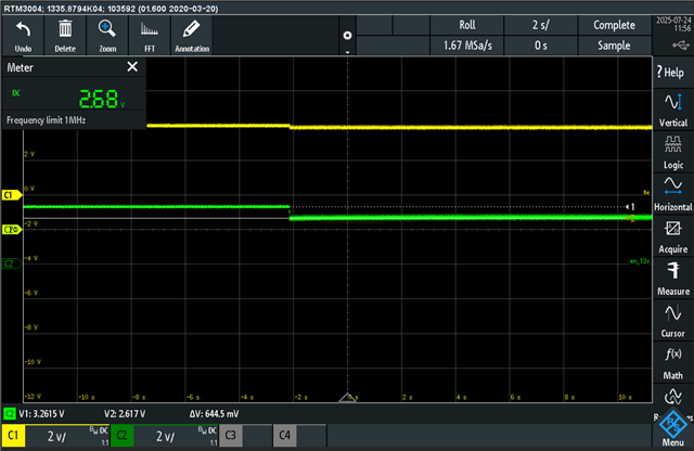

Hello
I would like to implement TPS22961 on my new development device that need Soft start solution with low drop voltage
I ordered the TPS22961EVM for pretest
My input i 4VDC and and output is a Digital Load with 1A
The VBAIS I sorted to ON pin and connected ti to GPIO = 3.3VDC or VIN
Below is a Vinput = 4VDC
Green, without load of 1A i got output = 3.26V
Green, with load of 1A i got = 2.61VDC
How it possible so big drop voltage ???? what i do wrong ??
